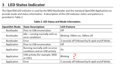

This tells me that the SDA micro must be running something in order to flash the LED D2, however I think it is not allowing the S32K144 to boot. The SDA debugger can not be detected in this situation from the NXP S32 design studio. A good starting point would be to explain what the flashing D2 means inside the SDA micro?

Is there a document for the open SDA micro to see what flashing D2 means?

I have tried to check the bootloader version, as best as I can tell it is as follows:
<input name="BOOTVER" type="hidden" id="BOOTVER" value="1.13" />
<input name="APPVER" type="hidden" id="APPVER" value="1.19" />
When I open the SDA_INFO.HTM it takes me to the https://www.pemicro.com/opensda/index.cfm, and I was unable to see the version in a web browser, so I check the HTML in a text editor.
Is this version of bootloader ok? I am not sure.
The bootloader document is also ambiguous, as there are 2 rows in the table for 'blinking'.
I didn't have a scope to measure the blinking duration on my visit, but it would be helpful if the duration of the application blink was specified, then I would know which issue I am seeing.
Sorry, I still dont know why micro will not boot when GPIO pins are high, can you help me some more please?
