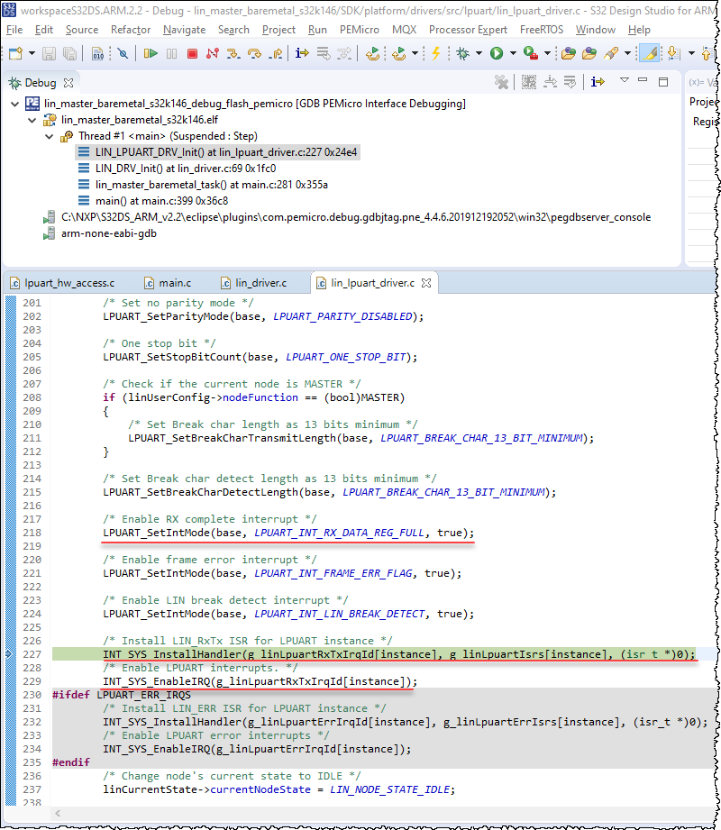

S32K144 As master node Is the data received from the Lin slave node through an interrupt

qiansan
However, in the execution process of the main function, I did not find the part of serial port interrupt service function registration, nor did I find the part of serial port interrupt enable. If Lin communication uses serial port interrupt to receive data, where is the interrupt enabled and where is the interrupt service function registered?

Robin_Shen
You can find them here:
