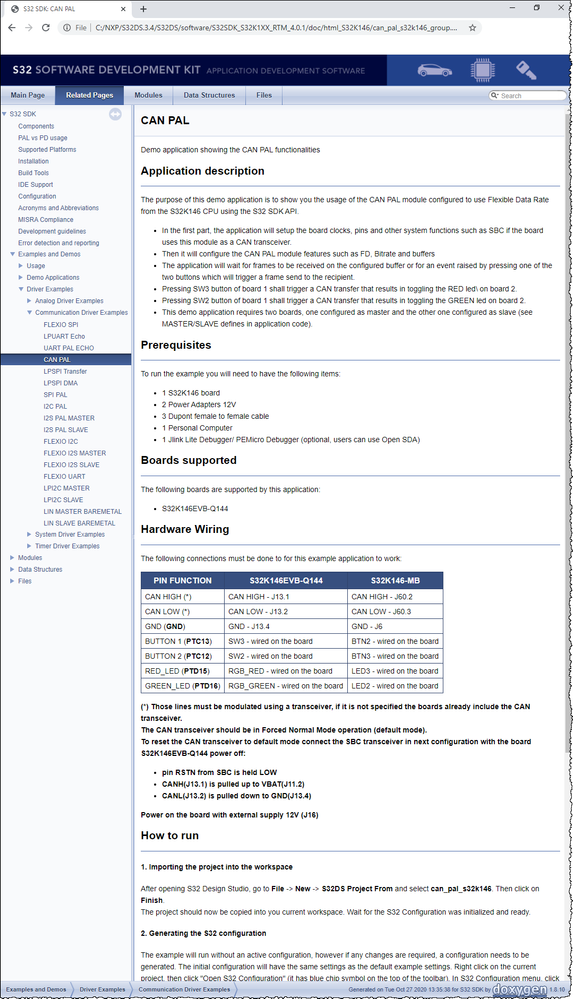

I need to use Can , send and recieve data ,if not use 12v,It seems Can0 not function(
UJA1169TK/F need the 12v power ?)

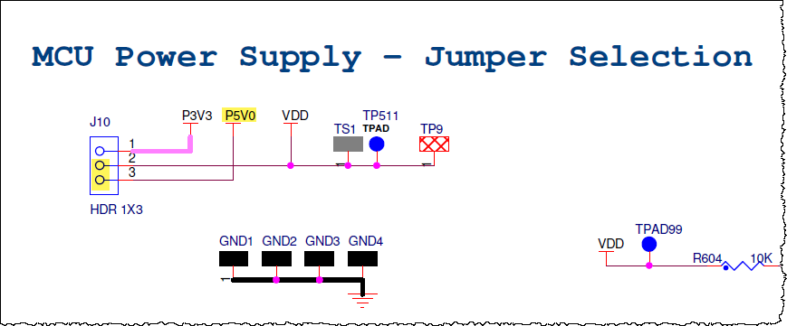

I want to use CAN transceiver to send and recieve,but the NXP S32K146 GPIO high is 3.3v,This is not work ,I need the Gpio is 5v. I kown, we can use the j10 to control the 3.3/5v,but it seems not work.

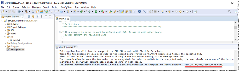

The example documentation can be found in the S32 SDK documentation at Examples and Demos section. (<SDK_PATH>/doc/Start_Here.html)
This mentioned that you need to use an external 12V power supply.

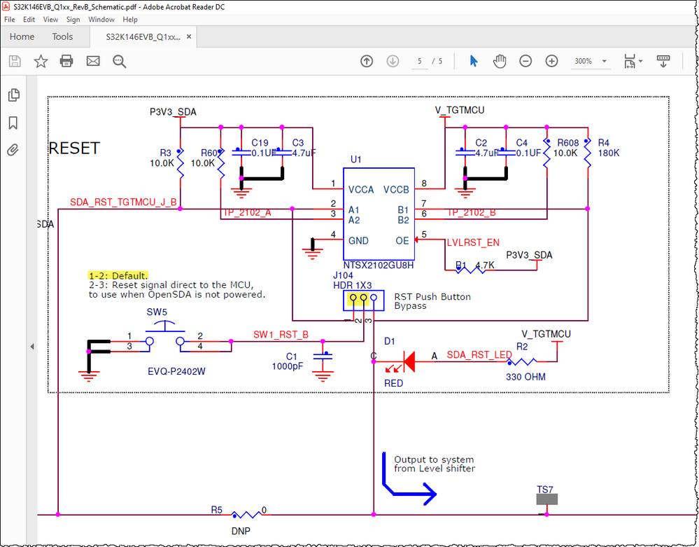

The image of your board shows that the setting of J10 need to change pin2-3.

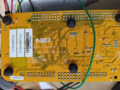

Please check if the version is SCH-29844 REV B at the bottom side of S32K146EVB.

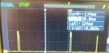

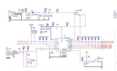

  Thank you for your reply. after read the schematic design and documentation, I konw I should  use the external 12V power supply to use Can demo. but the thing is that when I supply the 12v power, the mcu is always  reset.  I Capture the V_TGTMCU Singal, it seems when i supply the 12v power, is generate a Pulse(like under image ). My friends help me to read the power part schematic design, but is too hard to understand.
   konw, I can S32K146 other Can(not can0,and add CAN transceiver), the problem maybe is my mcu is damage(a few days ago, i can supply the 12v power to use can demo).  I want to konw how 12v power to the mcu (read the schematic design many times,but not understand,J16 ). why the reset sigal is generate. the  documentation show " Reset signal direct to the MCU, to use when OpenSDA is not powered" ,but the thing is OpenSDA have the power,D2 is green .

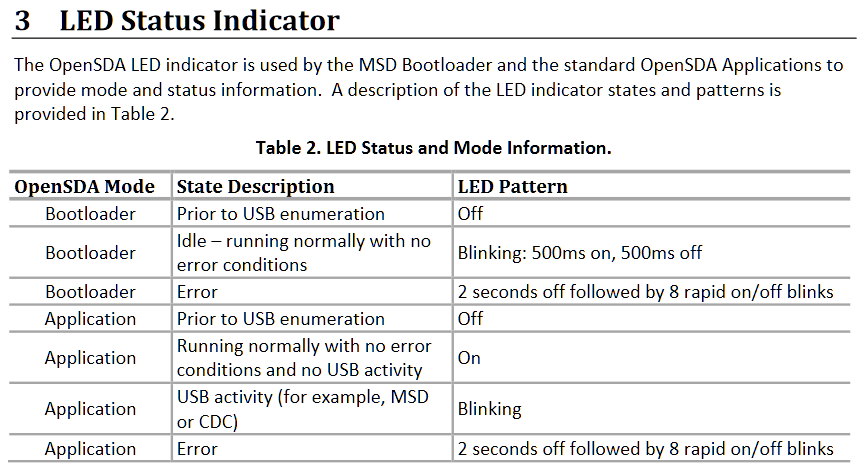

Does the D2 still blink?
In normal mode, the small green LED nearby the OpenSDA K20 device is off. And in BOOTLOADER mode the green LED blinks an error code.
The LED error codes are in section 3 of : http://www.nxp.com/files/32bit/doc/user_guide/OPENSDAUG.pdf:
OpenSDA LED Error Codes

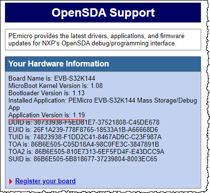

Please try to Enter OpenSDA Bootloader Mode and then click SDA_INFO.HTML check the Application Version.
If there is something wrong with Application Version of OpenSDA, please fix it first.
Otherwise I don't think you can debug and run code by using S32DS for ARM.

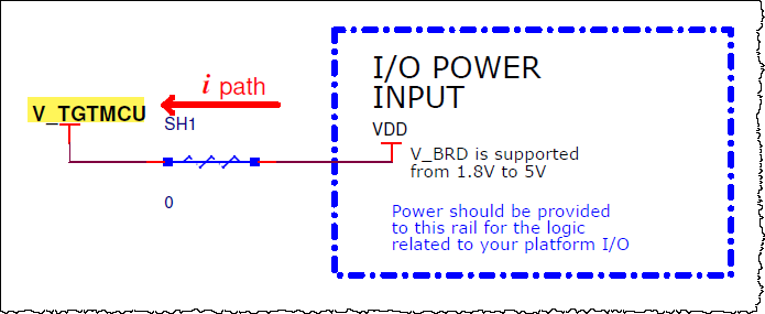

The pulse waveform is measured at V_TGTMCU or Pin3 of J104?
V_TGTMCU is power from VDD.
The pulse at Pin3 of J104 can be caused by MCU itself.(For example there is no program in it.)

 thank you for your reply,when I only use 12v power,red d1 is blink, green d2 is off, green d3 is  on.And it look something give the reset signal to the mcu,when I change the PTA5 to GPIO output( not  RST_TGTMCU_B function ),my code can run ok(but can not to debug the code, when I debug ,change the PAT5 function?)
our Hardware Engineer is help me to analyse the problem.but we has less experience to NXP, we think the mcu  NTSX2102GU8H  is broken or other problem.we capture many part to analyse . TP547(12.5V),TP522(12.4),P5V_SBC(5V) and so on.
the truely problem may 12v power generate  the reset singal, we dont konw How is generate. our team want to change the mcu,from tricore to nxp. but now,we have less experience  to nxp

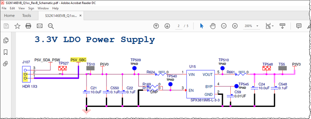

Fix OpenSDA don't need external 12V power, so please connect 2-3 of J107.
