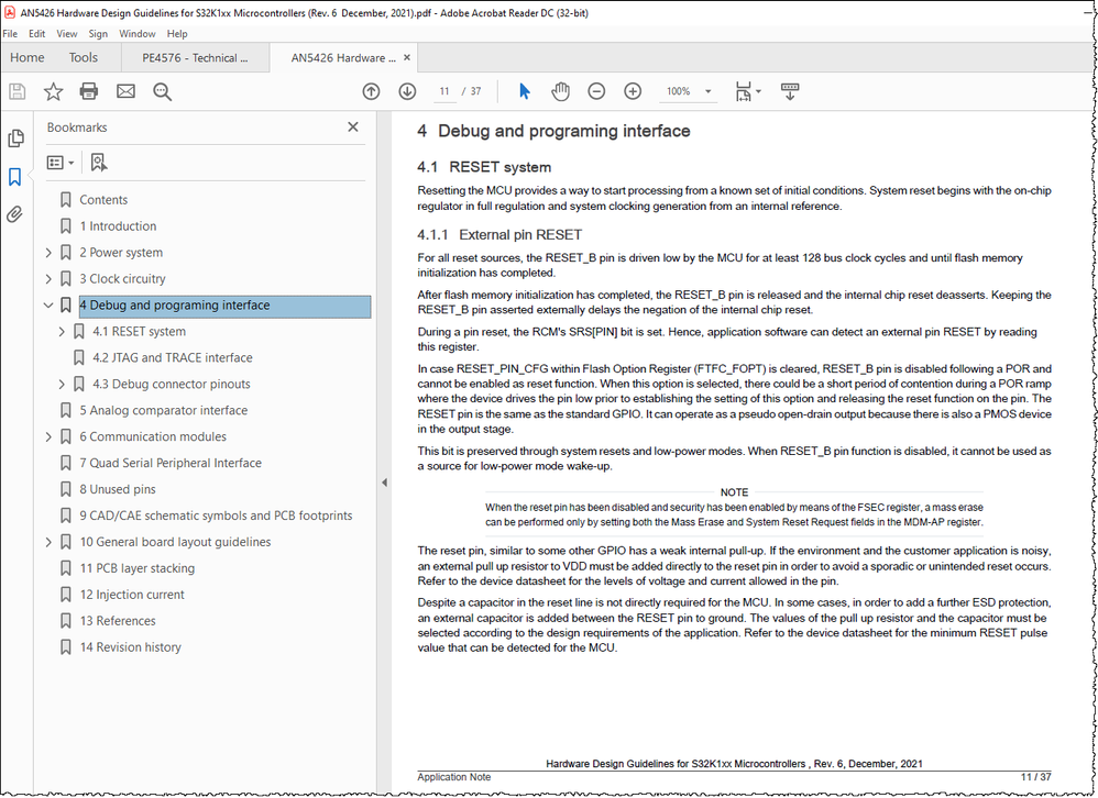

Please check the "4 Debug and programing interface" of AN5426: Hardware Design Guidelines for S32K1xx – Application Note
And no Power pin should be left unconnected. VDDx and VDDA/VREFH must be shorted together externally to a common reference on PCB.

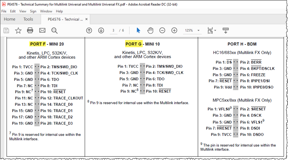

PORT F or PORT G did you connect to S32K144?( Multilink Universal/Universal FX Tech Summary)
Multilink Universal and Multilink Universal FX Pinouts - Ports A-H.pngMultilink Universal and Multilink Universal FX Pinouts - Ports A-H.png

We have connected PORT G with the S32k144 microcontroller. Also all the power pins are connected.
