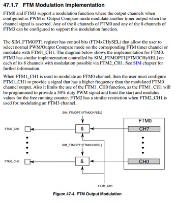

My team is attempting to apply spread spectrum to a 3-phase BLDC motor via PWM outputs, which are driven through the FTM0 peripheral. We are investigating the PWM modulation option to achieve this as mentioned in the reference manual:
It is still unclear to us the exact affect the modulation will have on the PWM output. Ideally, we are looking for something that will sweep(oscillate) the PWM frequency between a low limit (say 20KHz), and a high limit (say 22KHz). We would look into dithering as another option, but unfortunately we need to used FTM0 for our layout, and dithering is not supported on FTM0.
Can someone please explain how the PWM would behave if we applied a modulation of 2Khz on FTM0? Would it jump from 20KHz to 22KHz every few period cycles? Or will it randomly run at a frequency in between that range? Any clarification would be appreciated.
We have attempted to model this ourselves, but the instructions for setting up modulation are a bit unclear. I enabled the SIM->FTMOPT1 register to apply modulation on each of the 3 output channels
I also set up FTM1 channel 1 to output a PWM at 50% duty cycle at a frequency of 22KHz (2KHz higher than the FTM0 pwms). I applied a 10 tick deadtime and 1/16 deadtime pre-scale to match the FTM0 driver. This is the results I am getting (Yellow is the PWM output on FTM0, blue is the FTM1 output):
Here are the configurations for each FTM module:

I set the FTMOPT1 register before initializing the FTM peripherals using the following lines of code:
    SIM_Type * simeBase = SIM_BASE_PTRS;
    simeBase->FTMOPT1 |= SIM_FTMOPT1_FTM0_OUTSEL(0x2A); /* 0b101010 channels 1, 3, and 5 */
Is there something I am initializing incorrectly? This behavior does not seem correct. I would expect a consistent duty cycle each period with alternating frequencies in the range of 20kHz-22kHz. To clarify, I am using an S32K142W MCU with the SDK RTM v4.0.3.

The FTM Modulation Implementation for PWM mode using FTM0_OUTSEL register looks like this.
Without modulation:
Modulation with FTM1_CH1:
At the moment I only have on hand a S32K144-Q100 to test but it should be equal for the S32K142W.
I attach the project using S32 Design Studio for S32 Platform v.3.5 and RTD for S32K1 and S32M24x version 2.0.0 including patch P01.
Another way to perform modulation is using FAULT input signals, for more detail please refer to the following community posts:
https://community.nxp.com/t5/S32K/Modulated-PWM-waveform-Generation/m-p/656233
https://community.nxp.com/t5/S32K/FTM2-Output-Modulation/m-p/1056029
Hope it helps you.
Have a nice day!
