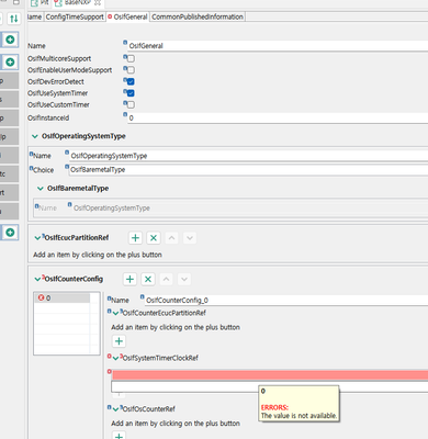

I am developing S32K314 on S32DS3.5.
RTD is as follows: : S32K3_RTD_3_0_0_P07_D2306_ASR_REL_4_7_REV_0000_20230629
In Add Component, try to set the value to Baremetal type in the BaseNXP tab. I'm trying to set OsfiUseSystemTimer and OsifSystemTimerclockRef, but I can't set the values.
Please help me what to do.
1,094 Views
jwkang
After updating to D2311, the ERROR for ClockRefer has been deleted.
However, a new error regarding Suil2_Port occurred. PortPin Mscr setting error.  -.-
So, I have now reverted back to the previous update, D2306.
Please provide the correct updated version for BareMetal clock.
