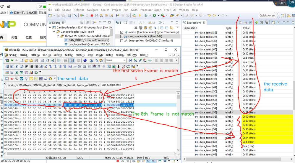

Why is there still data coverage  , use  CAN RX  for FIFO mode ??
The phenomenon is as follows:

hi Petr Stancik,
      As follows:i want to develop CAN bootloader for update;
                 1.   data_temp array    is used for update  PFlash data;
                               is from CAN interrupt
                 2.  CAN FIFO mode config:
                      a. CAN init  & CAN Filter config
                             I close CAN FD
                      b. start CAN recevie
                     c.intterupt
                  3. send  CAN message
                  I send  one CAN mesage  every 100 ms  through  CAN tools,
                  but  the  data_temp array  for recevie data   is  different form   the data   i  send
           Can you help  me  analyze  the question ?    thanks

hi,
     for example:

it seems the received yellow marked bytes are the one from address 50h of the srec file.
This may point you lost some frames. Do you call CanStartRecv() fast enough so RXFIFO can be read out? Should be called each time callback is executed.
BR, Petr
