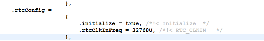

ambarish_hundek
I have configured RTC with external clock .
I 've used a crystal oscillator of 32.768KHZ which connected to RTC_CLKIN Pin.
My Configuration as below.
1.
2.
3.
4.In addition, I have configured the PA7's mux mode to PORT_MUX_ALT4 for Enabling RTC CLK_IN.
        .base          = PORTA,
        .pinPortIdx    = 7u,
        .pullConfig    = PORT_INTERNAL_PULL_NOT_ENABLED,
        .passiveFilter = false,
        .driveSelect   = PORT_LOW_DRIVE_STRENGTH,
        .mux           = PORT_MUX_ALT4,
        .pinLock       = false,
        .intConfig     = PORT_DMA_INT_DISABLED,
        .clearIntFlag  = false,
        .gpioBase      = PTA,
        .direction     = GPIO_INPUT_DIRECTION,
        .digitalFilter = false,
started the counter and read the RTC timer value , but RTC is not functional and reading the set time only .
Ambarish

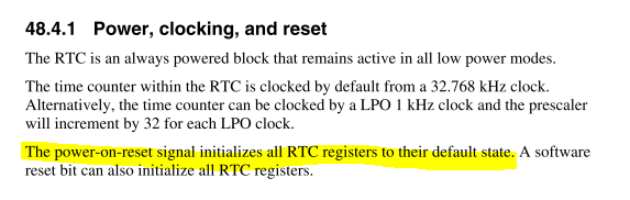

ambarish_hundek
Hello Lukas,
configuring the internal clock to internal RTC , I have set the RTC calendar and start the counter.
after power on reset , I am reading the RTC calendar, but it is reading the Year 1970 and different time values, it is not reading the last set values or may be last calendar time (before power on Reset).
Ambarish
7,225 Views
lukaszadrapa
from RM:
RTC works in all modes (including low power modes) and through reset but not without power.
If you want to keep time&date also when the power is off, you need external real time circuit with battery backup.
Lukas
