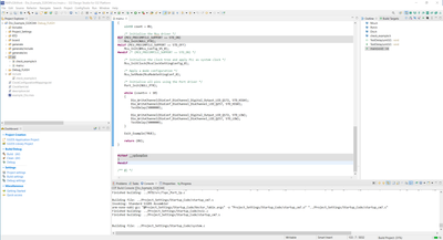

Hello ,
we just recived a the RD-HVBMSCTBUN , and I installed all necessery packages/Software in the s32ds.
I installed :
SW32K3_RTD_4.4_2.0.0_DS_updatesite_D2204
SW32K3_BMS_SDK_4.4_0.9.0_updatesite_D2210
SW32K3_BMS_SL_SDK_4.4_0.9.0_DEMO_updatesite_D2210
Installation of FreeMaster FMASTERSW31.exe
com.nxp.s32ds.s32k3.sdk.freemaster.v_3.0.repository_1.0.0.202212131557
FS26_4.4_1.0.0_RTM_DS_updatesite_D2209
and in order to start do some example I chose an example of DIO-Example-S32k344 to test our board.
1) I chose it from the sdk and of course I generate and update the code from the "S32 Configuration Tool"
2) I start builiding  FLASH (Debug_FLASH) but it stop at 31% in thise phase :
Building file: ../Project_Settings/Startup_Code/system.c
conclusion :
I dont know what is the steps : to start developing on the board , i chose to start with ``Dio_example`` just to make my first projects with the RD-HVBMSCTBUN, hoping to do the main purpose. making an hvbms.
thank you for your help.

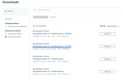

Hello Achraf,
I see you have installed the software in the S32DS 3.5. Unfortunately the HVBMS example is not compatible with the newer S32DS 3.5 version. Please download the older S32DS 3.4 version and please install it there. It is not mentioned in the installation guide, because at the time the HVBMS software example was developed, the latest S32DS version was 3.4.
https://www.nxp.com/design/software/development-software/s32-design-studio-ide/s32-design-studio-for...
With Best Regards,
Jozef

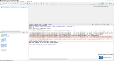

AchrafOukheir
I did a reinstallation , I installed all of packages and softwares that I need to run the example. I succed building the DIO example. However, when I am with the HVBMS example , It didn't work , I think its the linker
as you can see .
best regards.

JozefKozon
Hello Achraf,
With Best Regards,
