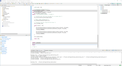

AchrafOukheir
I did a reinstallation , I installed all of packages and softwares that I need to run the example. I succed building the DIO example. However, when I am with the HVBMS example , It didn't work , I think its the linker
as you can see .

JozefKozon
Hello Achraf,
I see you have installed the software in the S32DS 3.5. Unfortunately the HVBMS example is not compatible with the newer S32DS 3.5 version. Please download the older S32DS 3.4 version and please install it there. It is not mentioned in the installation guide, because at the time the HVBMS software example was developed, the latest S32DS version was 3.4.
https://www.nxp.com/design/software/development-software/s32-design-studio-ide/s32-design-studio-for...
With Best Regards,
Jozef
