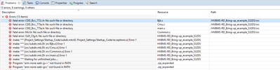

When trying to build the example I hace encountered these errors (image attached), how can I fix them?
Thank you!!

Dear Maitane,

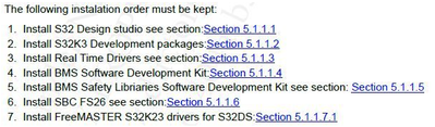

it looks, you haven't installed the HVBMS bring up example at all. Please uninstall the S32DS IDE from your PC and follow the order of installation below. It is very important to keep the installation order.
The prinscreen was taken from an UG763620. Please download the User Guide from this link

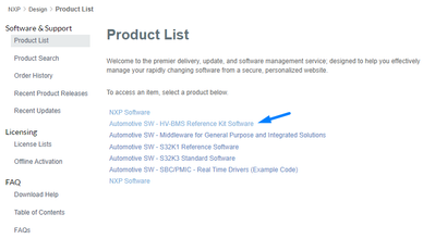

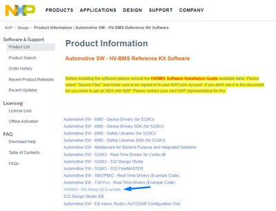

If you haven't downloaded the HVBMS bring up example yet, please download it from the NXP page. Please see below for procedure. You need to be registered on the page and your company needs to have a valid NDA (Non Disclosure Agreement) with NXP.
1.
2.
3.

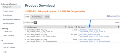

4.
5. Please download the latest version
6.
