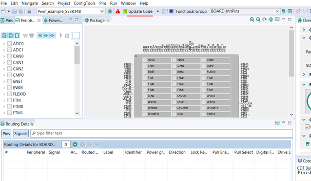

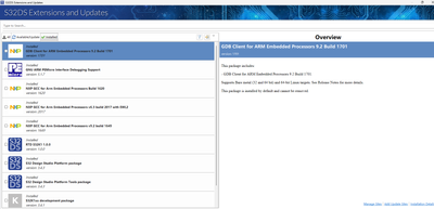

I installed DS32 version 3.4 and some needed package.
And I create a project based on Pwm_example_S32K148.When I try to build the project I get some errors like this:
1,476 Views
shangguanyu
I encountered a situation similar to yours. Have you resolved it?
../src/main.c:94:24: error: 'NUM_OF_CONFIGURED_PINS0' undeclared (first use in this function); did you mean 'NUM_OF_CONFIGURED_PINS'? 94 | Siul2_Port_Ip_Init(NUM_OF_CONFIGURED_PINS0, g_pin_mux_InitConfigArr0); | ^~~~~~~~~~~~~~~~~~~~~~~ | NUM_OF_CONFIGURED_PINS ../src/main.c:94:24: note: each undeclared identifier is reported only once for each function it appears in
3,282 Views
Senlent
Hi@iysheng
please click "update code" and then try it again.
3,263 Views
iysheng
After I do this ,when I build I get error messages as below:

 and the generated code releate is:
Port_Ci_Port_Ip_PinSettingsConfig g_pin_mux_InitConfigArr0[NUM_OF_CONFIGURED_PINS0] = {
.portBase = IP_PORTC,
.gpioBase = NULL_PTR,
.pinPortIdx = 19U,
.pullConfig = PORT_INTERNAL_PULL_NOT_ENABLED,
.driveStrength = PORT_DRIVE_STRENGTH_LOW,
.passiveFilter = (boolean)FALSE,
.mux = PORT_MUX_ALT2,
.lockRegister = PORT_LOCK_REGISTER_DISABLED,
.digitalFilter = (boolean)FALSE,
I found macro NUM_OF_CONFIGURED_PINS define as
