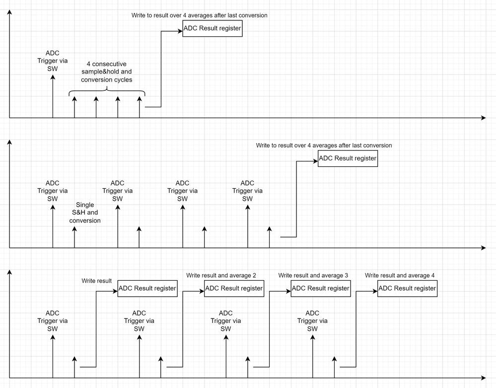

Hello there smart people,
I was wondering about how exatly the S32K3xx ADC behave if I enable averaging.
Let's say for example I have averaging for 4 conversions enabled:
Does it execute multiple S&H conversion cycles after one trigger happens (figure 1), does it wait for 4 triggers to occure and write the averaged result into the register (figure 2) or does it work like a moving average filter where every following result is taken into the average of the previous result (figure 3)?
I would love to hear back from you guys about this rater specific question.

The average function works as you describe in figure 1.
