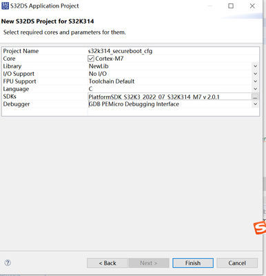

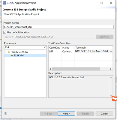

Ran into a very strange problem,
Projects created by S32DS cannot be debugged,
S32DS: 3.4
MCU :s32k314
RTD: 2.0.1
luhaiou_autolink_0-1709373776377.pngluhaiou_autolink_0-1709373776377.pngluhaiou_autolink_1-1709373818185.pngluhaiou_autolink_1-1709373818185.png
The simplest project that is created is directly debugged and cannot enter the main function normally
The newly created s32k344 and s32k312 projects can be debugged normally, only the s32K314 has an abnormality

Robin_Shen
Sorry for the inconvenience we bring you!
This may be caused by RTD bug, please refer to the following discussion:
About linker_flash_s32k314.ld file created with S32DS
S32K314 burn directly to "HardFault Handler"
If your project has just started, it is recommended to use the latest S32K3 RTD.
Robin
