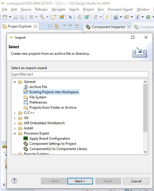

Hello there,
I have problems importing a project.I try to use the Sent receiver on the s32k144 EVB:
https://community.nxp.com/t5/S32K-Knowledge-Base/SENT-receiver-for-S32K118-Design-Studio/ta-p/112735...
and get the following error:
My steps were:
1. copy the Project folder into my workspace
2. And import it (import -> General -> Existing Projects into Workspace -> Finish)
Does anyone know how to fix it?

Please try to add Callback Name for DMA and try to modify the DMA0_IRQHandler:

Please try to import this project by using S32 Design Studio for Arm 2018.R1 – Windows/Linuxsent_rx_demo S32DS.jpg

When I import the Project with Arm 2018.R1 it says: Program "gcc" not found in Path.
I know there are some threads about it, but i couldn't find a solution yet.
Did you take any steps before importing the Project?
5,059 次查看
Robin_Shen
Copy the path of unzip project.
Import Existing Projects into Workspace.
Paste the path
I have installed S32DS_ARM_v2018.R1_UP11 before, it included S32 SDK S32K1xx RTM 3.0.0.
