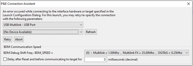

I imported an example project, build it without errors and want to flash it now.
But :
The Controller cannot be found by the program.
But the board is connected in the device manager.
What am I missing?

How did you connect the board to your PC? Did you use the USB Multilink device from P&E Micro and connect it to the PC via USB and the board via JTAG? That is the option shown in the image provided.
If you are instead connecting directly to the eval board, using only a USB cable, then you will want to select the option 'OpenSDA Embedded Debug - USB Port'.

Hello @mikedoidge,
thank you,
I guess I missed to change in debug configurations.
I tried an example project and flashing the board works.
