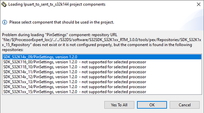

Hello there,
I have problems importing a project.I try to use the Sent receiver on the s32k144 EVB:
https://community.nxp.com/t5/S32K-Knowledge-Base/SENT-receiver-for-S32K118-Design-Studio/ta-p/112735...
and get the following error:
My steps were:
1. copy the Project folder into my workspace
2. And import it (import -> General -> Existing Projects into Workspace -> Finish)
Does anyone know how to fix it?

Ok, I tried several times and there are alot of things happening i do not understand.
I uninstalled s32 DS and installed again with update 11.
I import the file and:
First:
this pops up. (OK)

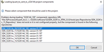

Second:
(OK)

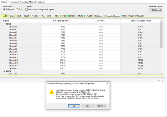

Third:
(Ja)
Which steps do I have to do now? Because if I debug it now, there are these Errors:
And yes I am new to this board and design studio

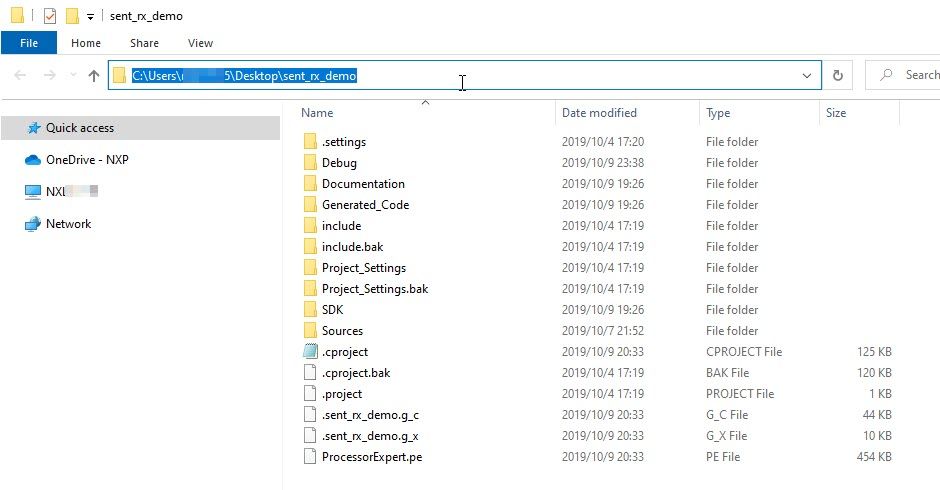

Robin_Shen
Copy the path of unzip project.
Import Existing Projects into Workspace.
Import Existing Projects into Workspace.jpgImport Existing Projects into Workspace.jpg
Paste the path
I have installed S32DS_ARM_v2018.R1_UP11 before, it included S32 SDK S32K1xx RTM 3.0.0.
