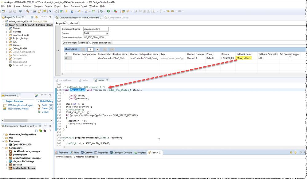

Please try to add Callback Name for DMA and try to modify the DMA0_IRQHandler:

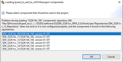

Ok, I tried several times and there are alot of things happening i do not understand.
I uninstalled s32 DS and installed again with update 11.
I import the file and:
First:
this pops up. (OK)
Second:
(OK)
Third:
(Ja)

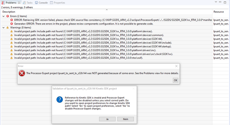

Which steps do I have to do now? Because if I debug it now, there are these Errors:

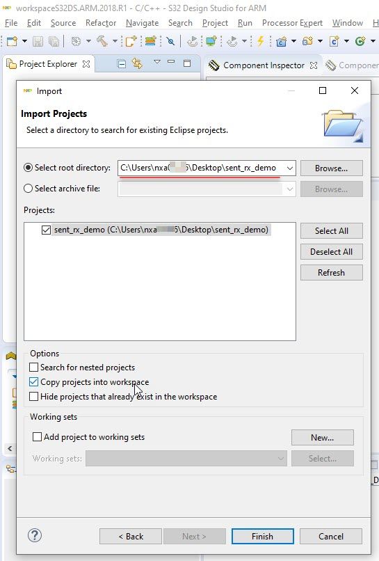

Robin_Shen
Copy the path of unzip project.
Import Existing Projects into Workspace.
Import Existing Projects into Workspace.jpgImport Existing Projects into Workspace.jpg
Paste the path
I have installed S32DS_ARM_v2018.R1_UP11 before, it included S32 SDK S32K1xx RTM 3.0.0.

Raphael2
I accidentally replied to the original post with my errors.
To add this:
I forgot to mention the Generation of the Processor Expert Code, but still those errors appear:
4,943件の閲覧回数
Raphael2

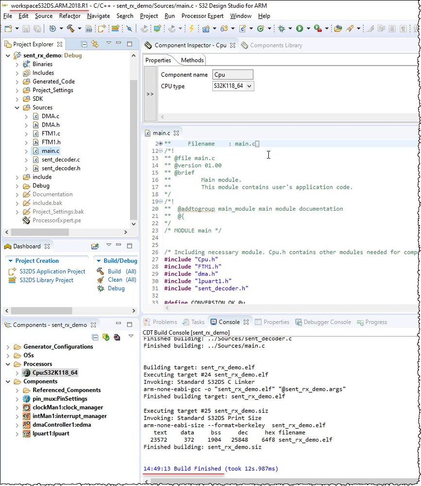

thank you very much!
I can build it now.
