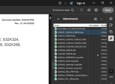

In S32K311_S32K310_IOMUX.xlsx file (S32K311_IO Signal Table sheet -> B column):
Note: To be able to see the attached documents of the reference manual you have to use a PDF reader such as Adobe Acrobat Reader.

PortPin Mscr values are incorrect.
Please use the following values:
We hope this resolves your issue.

Do you have more information on where these values are available or how to calculate or where to find them, thank you!
2,156 Views
_Leo_
