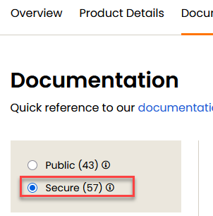

lukaszadrapa
It can be downloaded from https://www.nxp.com/products/S32K3
Documentation -> Secure files
Search for "RM00286 HSE-B Firmware Reference Manual - V2.5"
