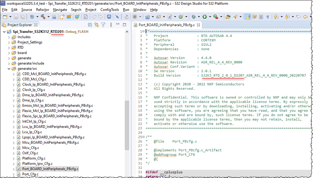

Robin_Shen
If the project is received from others. Please check the S32K3 Build Version of that project. For example: I imported Spi_Transfer_S32K312 of RTD 2.0.1, there you will see the version:
