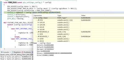

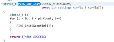

Issue:
During debugging, the program enters an infinite loop at the following line of code:
whale_3-1762846978134.pngwhale_3-1762846978134.pngwhale_4-1762846994486.pngwhale_4-1762846994486.pngwhale_5-1762847066215.pngwhale_5-1762847066215.png
`uint32_t regValue = config->base->PCR[config->pinPortIdx];`
This leads to the execution of the `DefaultISR` function:
Could you please advise on the potential cause of this issue and suggest possible solutions? I suspect the clock configuration or pin mapping might be the source of the problem.

I modified the lpuart_echo_s32k144 according to your instructions in S32DS v3.4 + S32K1 SDK 4.0.3, but I didn't encounter this error on my S32K144EVB-Q100.
This error seems to indicate that the clock gate of the PORT is not enabled.
For your board that doesn't have onboard crystal, I suggest modifying the Clock tool configuration to disable SCG.SOSC.
Additionally, for S32K1 SDK 4.0.x, it is recommended to use CLOCK_DRV_Init. For details, please see: SDK problem in S32 Design Studio for ARM 2.2

  CLOCK_DRV_Init(&clockMan1_InitConfig0);
  /* Initialize pins
   *    -    See PinSettings component for more info
  PINS_DRV_Init(NUM_OF_CONFIGURED_PINS0, g_pin_mux_InitConfigArr0);

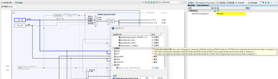

Hi @Robin_Shen ,
Following your instructions, I modified the clock initialization function, and I also disabled SOSC in the clock configuration interface. However, when generating the code, the following error occurred:
I'm not sure if this is the cause, but even after your modifications, the crash still occurs in the same place within PINS_Init.
How should I fix this?
