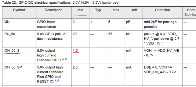

Hi Team,
How the pin PTE13(11) output should be defined, Specifically the min and max output voltages. Also define the maximum current capability of this pin.

Hi@Divyashree1
there is no Max output high current parameter.
the output voltage should be euqal to VDD_HV_A and the Min output high current should be no less than 1.6 mA.
