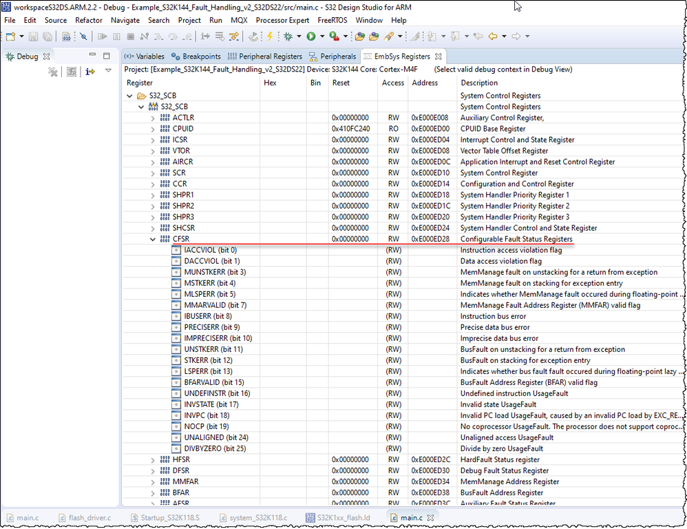

Which interrupt handler could be used to handle the fault due to accessing an invalid memory location by the application? If possible, please provide the IRQ number.

Configurable Fault Status Register (CFSR) can be found in Cortex -M4 Devices Generic User Guide

Hi Sreejith N,
Please refer to this article: Fault handling on S32K14x

Hi @Robin_Shen,
Thanks for your reply
But i couldn't  find the Configurable Fault Status Register (CSFR) on S32K146 reference manual or in S32K development kit. Is there any other register available in S32k146 for finding the exception occurred?
