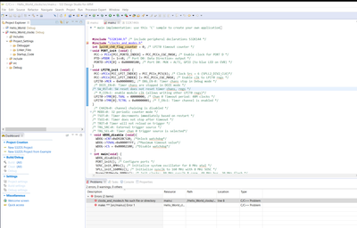

Hello there. I am new in this space. And trying to find my ropes here. I am following a s32k144 cookbook to get familar to the s32 design studio application and s32k144 board. And i have encountered the following error. Can any suggest me, how to resolve this. Is there any way i can add that missing file

Hi@akhilranga
 Have you added the clocks_and_modes.c & clock_and_modes.h to your project?
if no, you need to add these file to your project.
if yes,you may forget to add these file path,you can take a look at this post.
https://community.nxp.com/t5/S32K/S32K-S32DS-project-name-path-and-build-problem/td-p/1260029

akhilranga
Hello thee,
I didn't add them in my project. Hoping those files are available in NXP resources. May i know the process to add them in my project.
