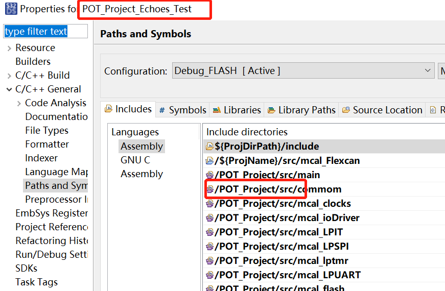

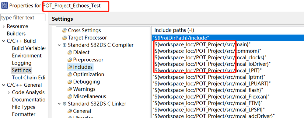

As I have an original project(It may called POT_project), I copy it into a new one, rename it(POT_project_Echoes_Test) and make modification on it. However, when I modify the source files and head files of new project and build the project, I find that the new project still assemble and build files from the old one, as in the configuration of c/c++ build->Settings->Tool Settings->Includes and c/c++ General->Paths and Symbols, these paths all have the file road of the old one.
So if there is a way to change all the old path into new settings, or replace all the old name into a new name?
It seems that I cannot put pic on the message, so I just copy the new project paths to express what I meaning.
In the new POT_project_Echoes_Test,
c/c++ build->Settings->Tool Settings->Includes:
"${workspace_loc:/POT_Project/src/main}" //POT_Project is the original project name

petervlna
The behavior is correct.
You have to do modification manually or create a new project with desired name and copy headers and source manually.
Peter
