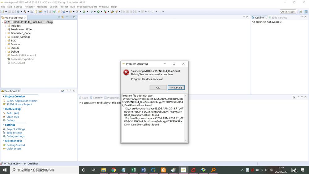

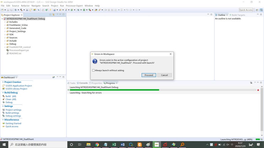

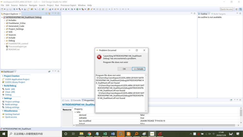

I bought a S32K144 development kit  MTRDEVKSPNK144, and I tried to operate the kit to rotate the PMSM motor, I followed every instruction in the document Quick Start Guide MTRDEVKSPNK144 S32K144 Development Kit for 3-phase PMSM , but in the step 9 (Debug the code), I encounter a problem, as the pic below
When I click Proceed, then S32 said, Program file does not exist, as the pic below
I tried to search the file ‘MTRDEVKSPNK144_DualShunt.elf’ on my disc, but there is none.
Could anyone help me to solve this problem?
Thanks a lot!

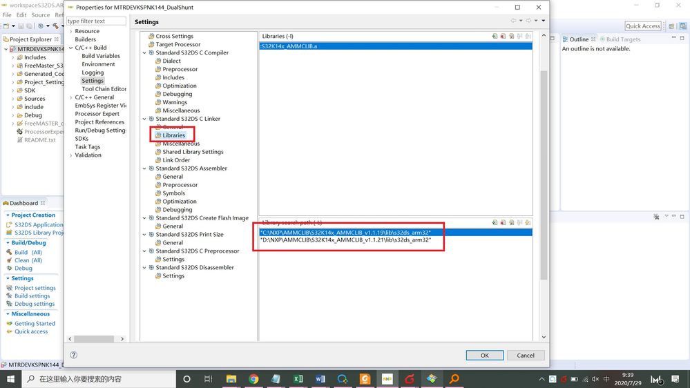

dianabatrlova

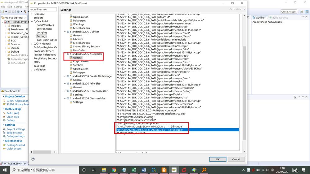

Your .elf is not generated because you have an error in your project. I assume that your errors will be related to the AMMCLIB path. This path should be changed, this is described in community thread below:
https://community.nxp.com/message/1267056?commentID=1267056#comment-1267056
I believe it helps.

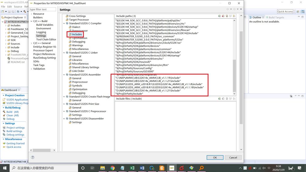

fuyanchao
Dear Diana,
 Thanks for your reply!
I followed the instructions you told me, as the pics below
But it still doesn't work.

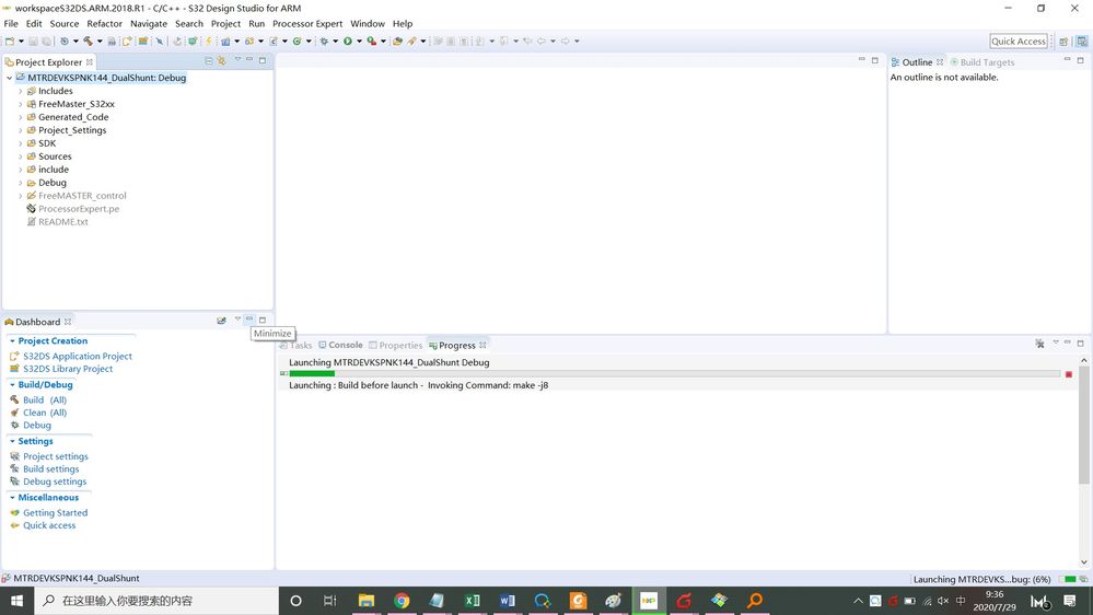

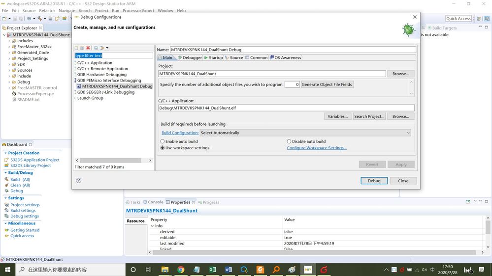

Every time I tried to debug the example project, S32 always stuck at 'Launching : Build before launch - invoking Command: make -j8',
And after several minutes, it failed,
At last, the same error happened, do you know why?
Thanks a lot in advance!

Please, delete the older one paths and clean the project (right-click on the project -> Clean project)

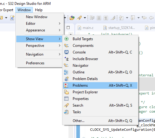

Also, please, just build your project (right-click on the project -> Build project) and show me the errors located in the "Problems" tab.

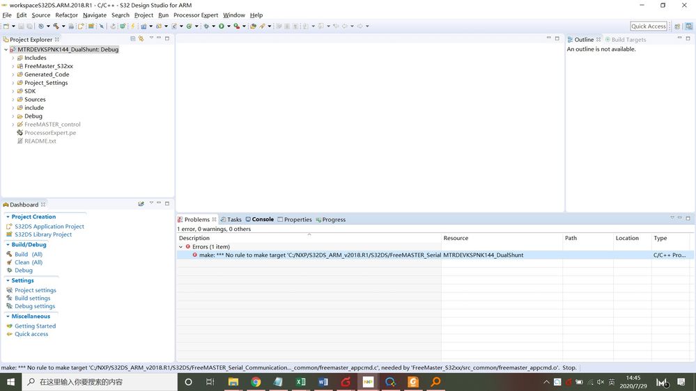

fuyanchao
Dear Diana,
It's really nice to hear from you, I am torturing by this error, really drive me crazy!
Please see the picture below, as your instruction.
The error is 'Description Resource Path Location Type make: *** No rule to make target C:/NXP/S32DS_ARM_v2018.R1/S32DS/FreeMASTER_Serial_Communication_Driver_V2_0/src_common/freemaster_appcmd.c', needed by 'FreeMaster_S32xx/src_common/freemaster_appcmd.o'. Stop. MTRDEVKSPNK144_DualShunt C/C++ Problem'
I know it is quiet late in your time zone, and I really thank you very much.
5,862 Views
dianabatrlova
Could you, please, check where this file 'freemaster_appcmd.c' is located in your file system?
This file is expected on this file path. I assume that you have it at a different place.
Diana

dianabatrlova

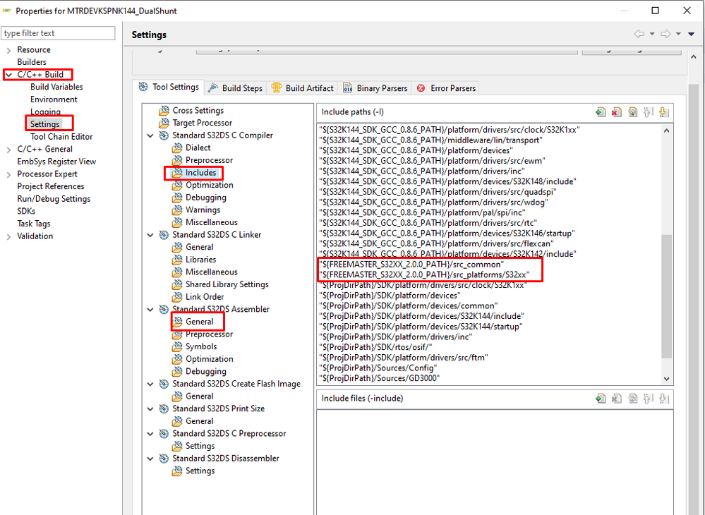

Instead of trying to add the missing file at that location. I assume you just need to change the file path in the properties of the project.
So, please, select the correct paths to these files:
Next time when you select the default location during the installation of S32Design Studio you will avoid these issues.
