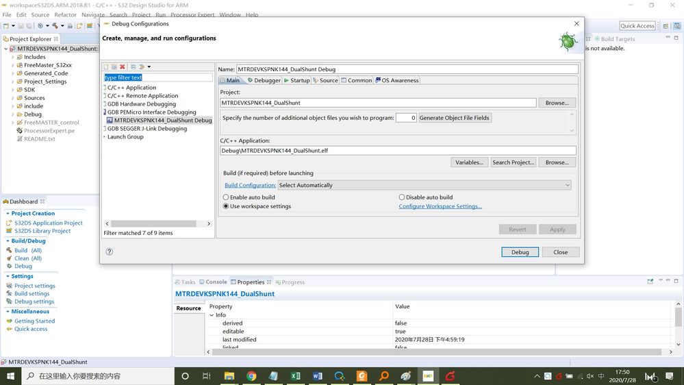

Hi there,

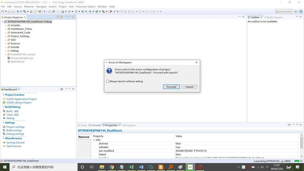

I bought a S32K144 development kit  MTRDEVKSPNK144, and I tried to operate the kit to rotate the PMSM motor, I followed every instruction in the document Quick Start Guide MTRDEVKSPNK144 S32K144 Development Kit for 3-phase PMSM , but in the step 9 (Debug the code), I encounter a problem, as the pic below

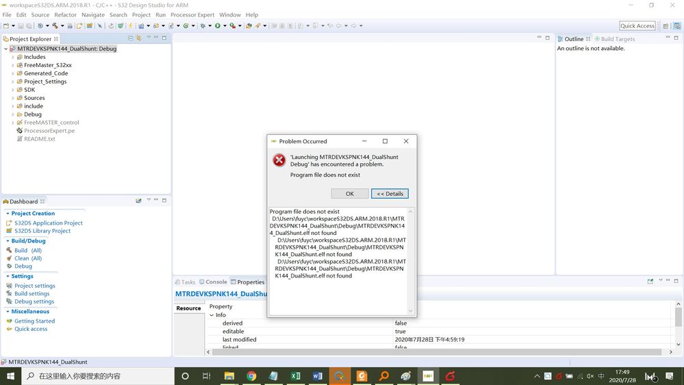

When I click Proceed, then S32 said, Program file does not exist, as the pic below
I tried to search the file ‘MTRDEVKSPNK144_DualShunt.elf’ on my disc, but there is none.
Could anyone help me to solve this problem?

dianabatrlova
Your .elf is not generated because you have an error in your project. I assume that your errors will be related to the AMMCLIB path. This path should be changed, this is described in community thread below:
https://community.nxp.com/message/1267056?commentID=1267056#comment-1267056
I believe it helps.

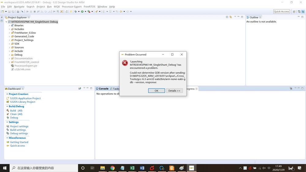

I added the missing file, but while I was trying to debug the code, another error occurred, S32 said 'Could not determine GDB version after sending: D:\NXP\S32DS_ARM_v2018.R1\eclipse\../Cross_Tools/gcc-6.3-arm32-eabi/bin/arm-none-eabi-gdb --version, response: '
Do you know how to solve this problem?

dianabatrlova
Instead of trying to add the missing file at that location. I assume you just need to change the file path in the properties of the project.
So, please, select the correct paths to these files:
Next time when you select the default location during the installation of S32Design Studio you will avoid these issues.
