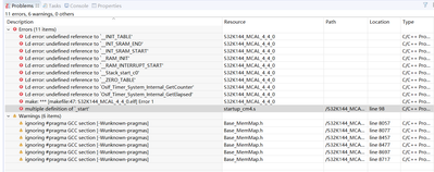

There have been many errors during the compilation process, some of which I have already dealt with, and there are still a few errors in the pictures. I look forward to your help. If you need any further information, please feel free to contact me.

The first issue (symbols error) is related to the linker file, please check this file and the startup file in your project.
The OsIf_Timer_System.. error => please check this symbol in your EB configuration and code.
Dan

I_Ningcaichen
Thank you very much. Most of the previous issues have been resolved, but there is still one issue that has not been resolved. I feel that there may be a problem with the settings, but I don't know exactly where the problem is. Do you know what caused this?

I_Ningcaichen
Hi @DanNguyenDuy :
I am pleased to inform you that this issue has also been resolved. I suspect that my startup file and standard file were run simultaneously, resulting in duplicate definitions. This has been resolved through this option in the image. Thank you!
