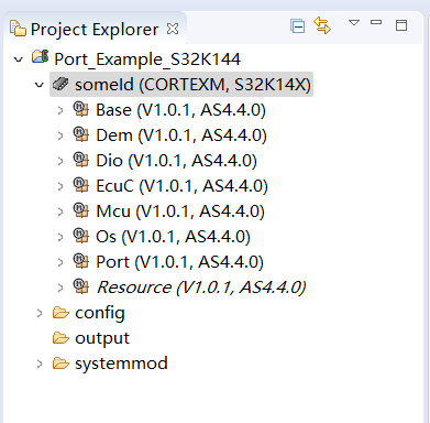

I am using the EB Tresos example project in the following path, which includes several modules in the image.
SW32K1_RTD_4.4_1.0.1_HF01_D2209\SW32K1_RTD_4.4_1.0.1_HF01\eclipse\plugins\Port_TS_T40D2M10I1R0\examples\EBT\Port_Example_S32K144\TresosProject\Port_Example_S32K144
This example project is used for the "S32K144EVB_Q100" development board, and the main function of the matched application is to control LED flashing.

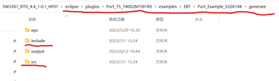

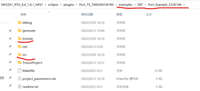

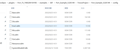

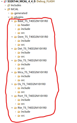

1. Copy Code:
Copy the code generated by EB Tresos (as shown in Figure 1 below) into the project to be compiled;
Copy the code from each plugin in the AUTOSAR software package (as shown in Figure 2 below) into the project to be compiled;
Copy the startup code from the AUTOSAR software package (as shown in Figures 3 and 4 below) into the project to be compiled.

DanNguyenDuy
Hello @I_Ningcaichen,
The first issue (symbols error) is related to the linker file, please check this file and the startup file in your project.
The OsIf_Timer_System.. error => please check this symbol in your EB configuration and code.
Dan

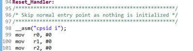

I_Ningcaichen
Hi @DanNguyenDuy :
I am pleased to inform you that this issue has also been resolved. I suspect that my startup file and standard file were run simultaneously, resulting in duplicate definitions. This has been resolved through this option in the image. Thank you!
