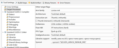

I am pleased to inform you that this issue has also been resolved. I suspect that my startup file and standard file were run simultaneously, resulting in duplicate definitions. This has been resolved through this option in the image. Thank you!

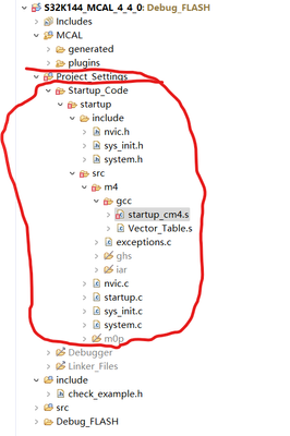

1. Copy Code:
Copy the code generated by EB Tresos (as shown in Figure 1 below) into the project to be compiled;
Copy the code from each plugin in the AUTOSAR software package (as shown in Figure 2 below) into the project to be compiled;

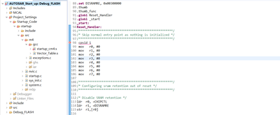

Copy the startup code from the AUTOSAR software package (as shown in Figures 3 and 4 below) into the project to be compiled.

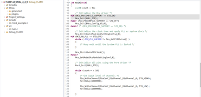

2. Copy Application Code
Copy an application code from the AUTOSAR software package example project, whose function is to control the LED on and off by adjusting the GPIO pin output level.

Hi @DanNguyenDuy :
