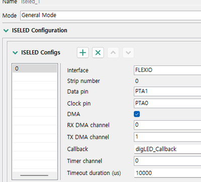

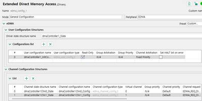

ISELED setting by Design studio
shudii_0-1654756704111.pngshudii_0-1654756704111.pngshudii_1-1654756717880.pngshudii_1-1654756717880.pngshudii_2-1654756730753.pngshudii_2-1654756730753.png

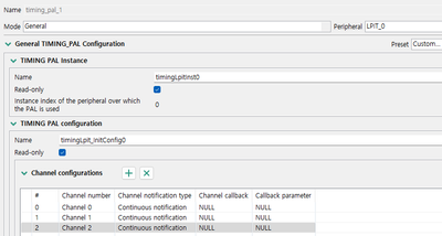

timing_pal_1 channel 0 is used for ISELED timeout. Another is for my application.

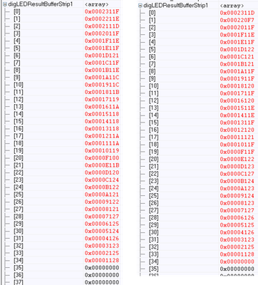

digLED_Read_Diagnostic, digLED_Read_Temp commands are sometimes occur timeout from DMA callback.
Actually, Tx, Rx total time is not over 3ms for 35 leds.
show  below pictures.
Left is a normal, right is abnormal data, buffer[2]'s data should be 0x21's LED data.
So, as right case, I lost a one led data.
This situation is more happend when my CAN driver is working.
If I not use a CAN, then that is reduced.
(my CAN stack is generated by VECTOR GENy tools)
shudii_1-1654755242874.pngshudii_1-1654755242874.png  <---- It's 35 led data. but In my buffer, just 34 data.
I want's know a detail reason and solutions........

The point is, there are only two possible cases: either the data from LEDs can be read before timeout, or the timeout occurred. If the digLED_BUSY couldn't be out although the transmission was finished, then probably the interrupt weren't installed correctly, or the application reached a state where there were some blocking that prevent these ISRs to be executed. In that case, there is no other option but to reset the MCU, since the root cause wasn't from the ISELED itself.
