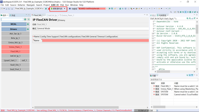

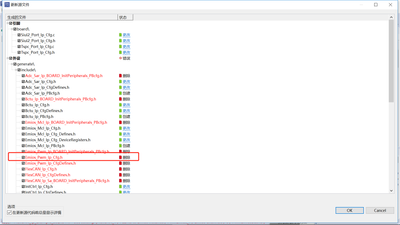

Colleague's application directly to me, I have given to modify the configuration of inside, and then update the source code, but appeared before the file deleted, it established a different name. H file, but the. H file name changed after that program there will be some contents path before use, but can't find the file, lead to errors.

机制应该就是这样的,生成的配置文件会根据你当前配置的模块生成,多余的配置模块会提示你要不要删除,你Emos和FlexCAN配置模块都报错,那它是无法生成配置文件的,那就会提示你文件夹下下面旧有的配置文件是否要删除。
