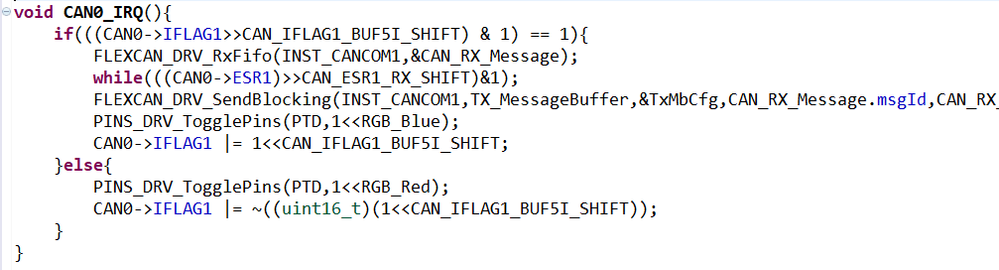

hello:
I'm using s32k144 EVB board to test CAN module. The function i want to realize is receiving one CAN message from computer and then sending this message to computer via interrupt.
I configure CAN0 with RX FIFO mode and enable the corresponding interrupt. I can send a default CAN message at the start of the program. I also see the blue light twinkling as a flag of CAN module receiving normally while i don't read that CAN message. However, I can't read this CAN message to a message variable. When i use the function FLEXCAN_DRV_RxFifo in the interrupt, it only send back a default CAN message for the first time and then have no reaction for next CAN message.
The interrupt i enable is CAN0_ORed_0_15_MB_IRQn, and the interrupt handler is shown below:
Besides, i use S32DS_ARM_v2018.R1  as IDE and EAR SDK v0.8.6 for assistance.

Dear PetrS:
Thanks for your suggestion. Although i download the V2.2 S32DS IDE with RTM 3.0.0 SDK, my project still don't work. There might be some key points about how to use SDK functions that i haven't understand. So i write a ReceiveFifo function referring to the datasheet by myself. Lucky, it works. My function is attached below. Still, thanks again!

PetrS
I can suggest to use newer SDK version, now RTM 3.0.3. Try to update SDK from the S32DS you have.
Or install S32DS v 2.2; https://community.nxp.com/t5/S32-Design-Studio-Knowledge-Base/S32-Design-Studio-for-ARM-2-2-Windows-...
Some example with RXFIFO usage can be found in https://community.nxp.com/t5/S32K-Knowledge-Base/Example-S32K144-FlexCAN-RXFIFO-DMA-S32DS-ARM-2018-R...
BR, Petr
