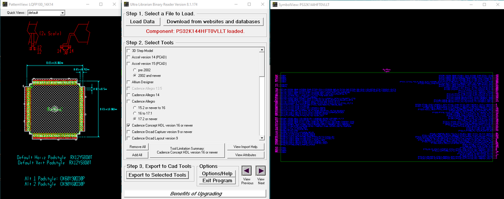

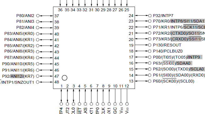

I want to find a pin configuration figure like the one below to make a symbol for schematic. I have looked for it in the data sheet and reference manual of S32K mcu, but found nothing. Can anyone help?

Please check if the symbol of S32K144 on the website "Microcontroller Symbols, Footprints and Models" meet your needs.
Microcontroller Symbols, Footprints and Models.pngSymbol PS32K144HFT0VLLT.png

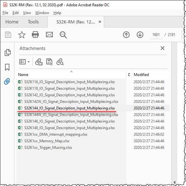

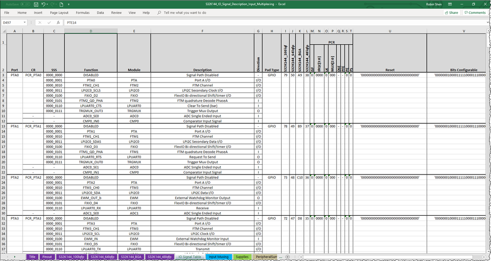

You can also open the S32K144_IO_Signal_Description_Input_Multiplexing.xlsx in S32K1xx MCU Family - Reference Manual .
Check the information in it.
S32K144_IO_Signal_Description_Input_Multiplexing.pngS32K144_100lqfp S32K144_IO_Signal_Description_Input_Multiplexing.pngIO Signal Table S32K144_IO_Signal_Description_Input_Multiplexing.png
