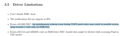

It's needed to config 1 MCU mode setting VLPS besides RUN mode in EB Tresos.
After that, config 1 timer to wakeup MCU from VLPS. However, I tried to use Lpit but unable to wakeup VLPS, but RTC and LPTMR can wakeup VLPS. I think it 's relating to the errata from UM:
My example is tested using S32K144, RTD 1.0.1.

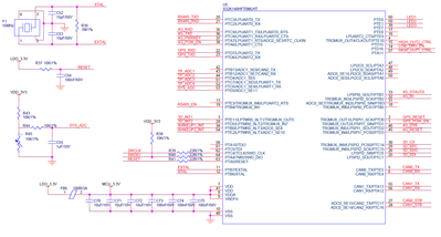

I use S32k146 64pin mcu and modify the EB project you provide to fit my own board. When it run the Mcu_SetMode(VLPS) , it could not wakeup again either. Does this function need other hardware besides MCU? The hardware schematic diagram as bellow, please help me with this problem. Thanks!!

So in case to keep line 43(Mcu_SetMode(VLPS)), The LPTMR notification can be triggered or not?
I checked documents and your config, there's nothing seems to be wrong.
Can you check the wakeup source RTC also? is it able to wakeup Mcu by RTC?
