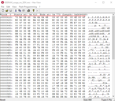

I am trying to work on the EEE for S32K116 chip for the quick write access.
I have seen a picture like below for the generated flash image.
Could someone please tell me how to include the FlexRAM section into the flash image?

If FlexRAM is used as access point for EEPROM emulation, from to project point of view it acts as RAM, so it is accesses as RAM (as so it cannot be included in the flash image).
If FlexRAM is used as SRAM, it is just SRAM and so it is the same case.

What I want to achieve is to be able to view EEPROM values in the flash image after build.

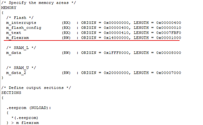

For example, in the linker file, the section for FlexRAM has been specified as below:
But the flash image after build, as below doesn't have the FlexRAM section.
Could you please tell me is that something wrong with my configuration?

Linker file seems to be more or less correct (address range is 0x14000000 - 0x140007FF).
But I don't understand why you expect it'll be visible in flash image when it is de facto RAM memory. SRAM data you don't see there as well.

I just wondering if it will be possible to include FlexRAM information into the flash image, since I have seen that picture got  FlexRAM section into the flash image. I never see this before, that's why I am curious how this get done.

Just open memory dump window at FlexRam address range. In the screenshots above you are showing flash image (S-record) what's something completely different (it is image to be downloaded to internal code FLASH memory).
