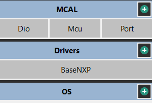

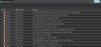

cranes
Hi VaneB,
Here is what's installed in my S32DS:
The errors are like this:
These are the components added without configuring anything.
After adding the components of Dio and Ecu without configuring anything, the errors stay the same.
After removing Siul2_Port in Drivers, the errors keep the same.
Crane

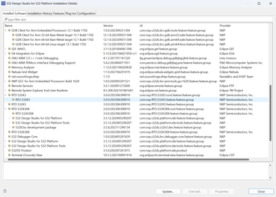

15,960 次查看
VaneB
Hi @cranes
I tested it from my side and I cannot reproduce your issue. I am attaching an image of my installation details, please help me validate that you have the same package version.
15,958 次查看
cranes
Hi VaneB,
I am using S32DS 3.5. I didn't find the same page as shown in the screenshot. This is what I see:
It look having everything. Although the information about RTD is not clear, its detailed info can be found in the screenshot shared in my last post.
Thanks!
Crane

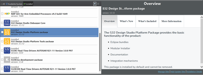

Hello VaneB,
I didn't uninstall the old one as I still need to use it for other projects. I installed a brand new version S32DS at C:/NXP/S32DS.3.5_b (The original one is at C:/NXP/S32DS.3.5). The installed packages are like this:
Then create a new application project. This time, there is no "OS" in the components. But still get the same errors after adding "Port".
Any idea about what else might be missing?
Thanks!
Crane

VaneB
Hi @cranes
I think that the problem could be related to a typo in the files located at C:\NXP\S32DS.3.5\eclipse\mcu_data\components\PlatformSDK_S32K3 like Port_PBcfg.c as mentioned in the shared message error.  Please share the files mentioned in the messages errors, to verify if this is the situation. Also, please share your full installation details and how the project was created.
15,709 次查看

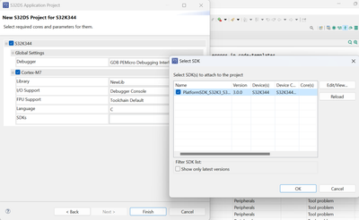

cranes
Hi VaneB,
The two files are attached.
This is the screenshot of the installation details. I don't see how it can be exported.
This is how I generate the project:
1. Create a new S32DS application project
2. set project name and MCU
3. configure the project
4. open the .mex file and disable the Pin configuration tool
5. open the peripheral tool and click "+" next to MCAL and choose "Port" in the pop-up window
6. click "OK" and then I see this
In step 3, I tried choose "No IO" for "IO support" as well. And the result is the same.
Thanks!
