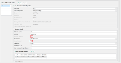

hi, nxp community. my name is seokhyeon.
i face something problem using S32DS for development LIN SW.
my question is simple in driver, how to change ldf protocolversion?
it is, default and fixed 2.1 version.
i need to use 2.2 version.
already check LIN Transceiver is can support lin 2.2 because my board is S32k144EVB.
lin transceiver is TJA1027
please answer.

Hi @seokhyeonwang,
The linstack package is applicable to for all three versions LIN2.x and J2602 (J2602/1_200509), this includes 2.0, 2.1 and 2.2. So, you do not need to do any additional changes.
From the release notes: "The LIN Stack package is compliant to LIN 2.0 and LIN 2.1 / 2.2a specifications"
Julián
