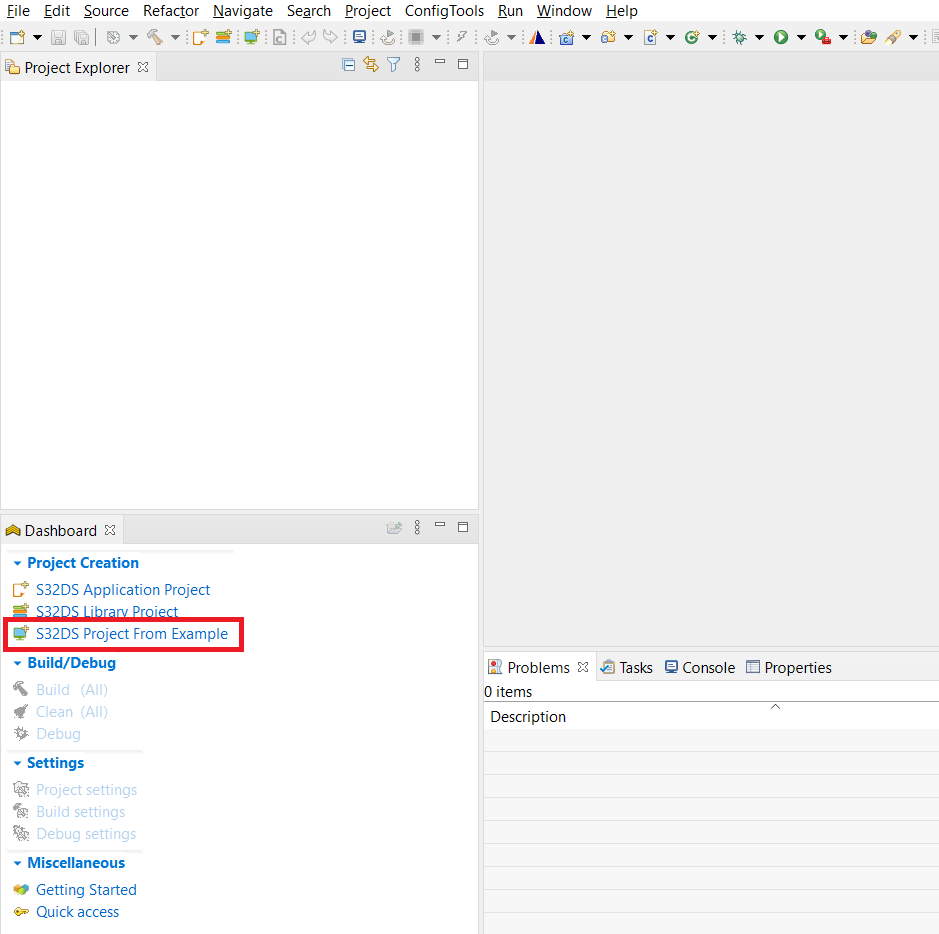

1. Launch S32 Design Studio
2. Use quick S32DS Project from Example button from Dashboard.

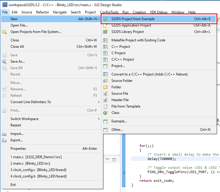

 or select File -> New -> S32DS Project From Example

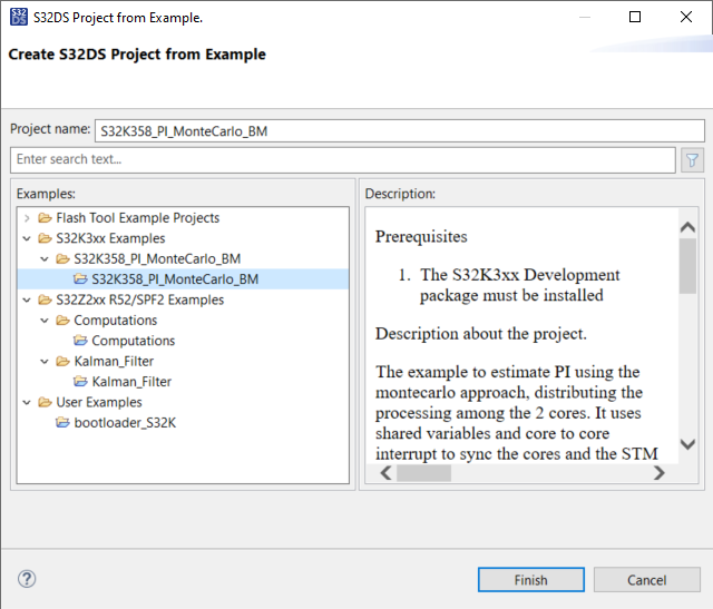

3. Select one of the projects, for example, S32K58_PI_MonteCarlo_BM. Click Finish.
4. The project is added to the current workspace. It is ready to be built and can be executed on the target.
