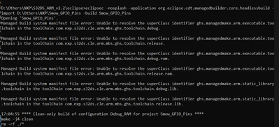

I was trying to build a project using the command prompt , on board S32K144 .
For importing , I faced the below issue
For building , I faced the below issue .
So in the "D:\Others\NXP\S32DS_ARM_v2.2\eclipse" directory I have run the below commands :
eclipsec.exe -nosplash -application org.eclipse.cdt.managedbuilder.core.headlessbuild --launcher.suppressErrors -data D:\Others\NXP demo codes -import D:\Others\NXP demo codes\Read_Pin
eclipsec.exe -nosplash -application org.eclipse.cdt.managedbuilder.core.headlessbuild --launcher.suppressErrors -data D:\Others\NXP_demo_codes -build Read_Pin

Hi @smow_chandan18,
You can refer to the following post for instructions on importing and compiling: HOWTO: S32 Design Studio Command Line Interface - NXP Community
The syntax for the command is the following:
eclipse -nosplash
        -import {[uri:/]/path/to/project}
        -build {project_name | all}
        -cleanBuild {project_name | all}
 So, for example, with the workspace at "C:\Users\nxp\workspaceS32DS.3.5\" and the project to import at "C:\Projects\CANFD_MCAL_S32K344", you can use the following template, which will generate all the files at "CANFD_MCAL_S32K344/Debug_FLASH".
eclipsec.exe -nosplash -application org.eclipse.cdt.managedbuilder.core.headlessbuild -data C:\Users\nxp\workspaceS32DS.3.5\ -import C:\Projects\CANFD_MCAL_S32K344 -cleanBuild CANFD_MCAL_S32K344/Debug_FLASH
Julián

Hii @Julián_AragónM ,
I have used the build commands provided by you which did help me to build the projects but they weren't producing any .elf file which is need for flashing the project .
I have uploaded the result of the build command above
The command written is above .
So I want to know about the commands which would help me with producing the .elf file .
Also I would like to get the flash commands for flashing the files on command prompt .
Chandan .
