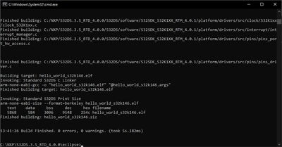

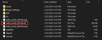

I've tested a hello_world example just as a test:
The .elf should be generated in the specified folder (in my case, \Debug_FLASH

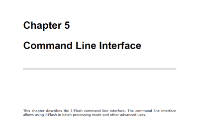

Also, for flashing the device, you could use either PROG Flash Programming Software (Customer Classic Interfaceor J-Link's Flash Download, which includes support for CLI:
Keep in mind you need a debugger from the respective program in order to program the device.

Just FYI, SEGGER's J-Flash is free of cost as of now, and the guide for CLI is inside the installation path.
Looking though Erich Styger's post it seems to be a generic solution for debugging. Since S32DS uses the same plugins this should work. Keep in mind you need the external debugger.
