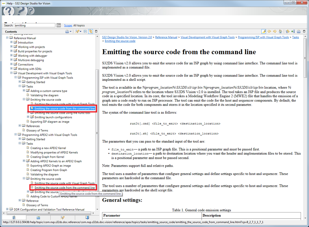

S32 Design Studio for Vision
Emitting the source code from the command line: There are 2 sections in the Reference Manual, one for each of the ISP and APEX2 Visual Graph Tools.

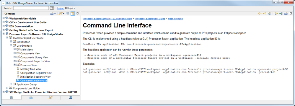

Processor Expert Software - S32 Design Studio
There is a section in the Processor Expert User Guide titled 'Command Line Interface'
