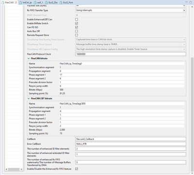

Would it be possible to screenshot the peripheral page on your end to show me the following
ip config interrupt controller
flexCan configuration

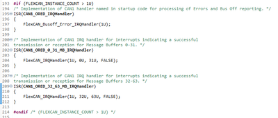

Also does the CAN0_ORED_0_31_MB_IRQHandler handler need to be changed for different CAN channels? I am using flexcan_1 and I do not know if that is causing any issues. When I used loopback mode it was working fine but I'm not sure

Here is the configuration for the project:
For the IRQs, you can see them declared in the FlexCAN_Ip_IRQ.c file:
And finally, for the FlexCAN MB, each individual message buffer is 16, 24, 40, or 72 bytes, depending on the quantity of data bytes allocated for the message payload: 8, 16, 32, or 64 data bytes, respectively. Please refer to chapter 73.6.3 from the S32K3 Reference Manual.
