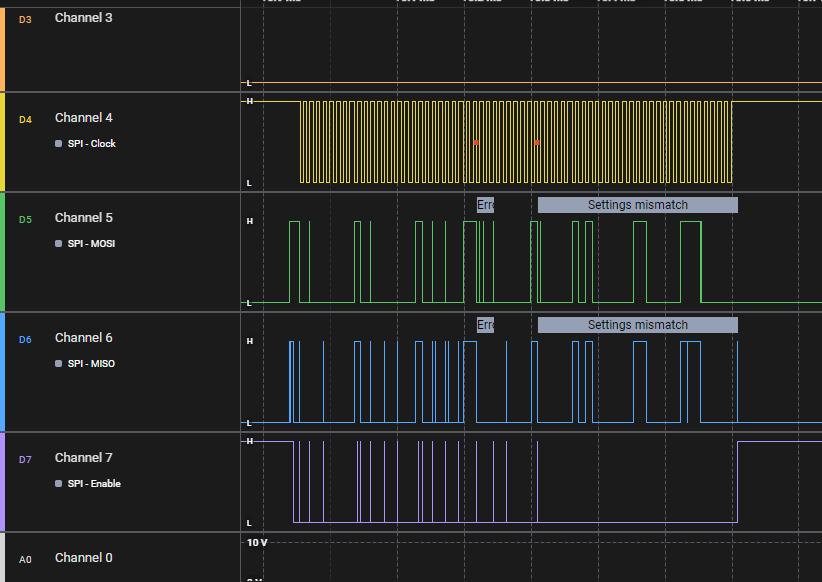

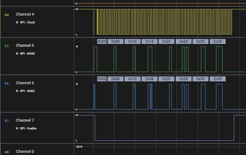

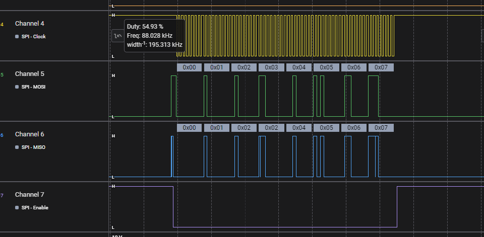

I am working on SPI on the S32k3x Q172 Board the data is getting disturbed due to Clock/Enable line disturbances I have connected the SPI lines to the logic analyser i have observed a pattern that the clock pulse and enable line is disturbing and then data is getting corrupted ,could any one give me a solution to configure the SPI Master on S32k344 .
Sometimes I am getting the correct data but most of the time i am getting the error or incorrect data i am sending 0x1,0x2,0x3,0x4,0x5,0x6,0x7 and most of the time i am getting corrupted data i am attaching the imagesnxp1.PNGnxp1.PNGnxp2.PNGnxp2.PNGnxp3.PNGnxp3.PNG

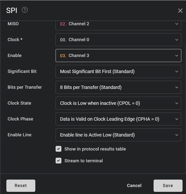

Have you tested my code that I have shared in the post, For me I am getting some disturbances on the Enable Line. Can you share the code that you have tested or the configurations that you have done in the logic analyzer configuration side.

Regarding the Logic Analyzer, we used the default configuration:
Hope it helps you.

From the images shared above we observe that the message coming from the Slave changes between images, we suggest you check the configuration of your Slave and Analyzer.
We have tested data transmission from the master (S32K344) and observed consistent behavior. See the image below:
