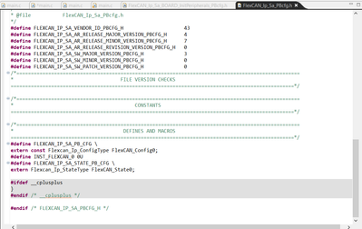

Hello I am trying to run the FlexCAN_Ip_Example_S32K344 example on a 342 but I am running into the issue of some names being different between the two SDKs, what do I need to convert the three errors to?

PetrS
those variables are generated in FlexCAN_Ip_Sa_PBcfg.c/.h located in project generate folder.
So either code is not generated from Config tool, or project does not include generate\src\ and generate\include\ into project paths.

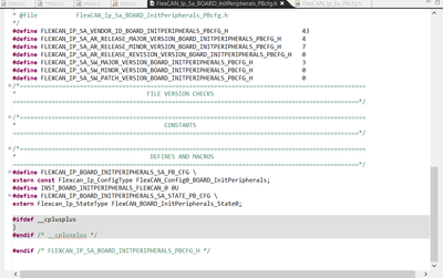

pb632146
Contributor V
I've been experiencing this a lot actually, I don't understand why the generated includes between the 342 and 344 sdks are different. First is the 342 include, second is 344. At any rate thank you for pointing to the file.
