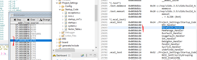

Left view is on Text editor and right is S32DS debugger.
And last memory is below.
And then jump to application
FunctionPointer functionPtr = (FunctionPointer)(*(uint32 *)0x00500000);
(functionPtr )();
HardFault_Handler will occurr.
How do I jump to 0x00400000 or 0x00500000 position after completing Flash write with Bootloader?

Sdeveloper
Hi @not_a_duck
thanks for your suggestion i tried with the procedure you indicated me but I still can't run the application, the applications gets stuck in HardFault_Handler (image below).
Do you have any further suggestion? Did you perform any specific modification in the application linker file?
Thank you again and BR,
