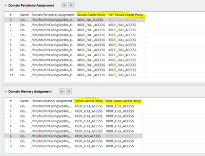

What is Secure Access policy and non secure access policy? What is the difference between them?
I didnt find any info regarding this S32K3 RM and RM UM.

These define the access depending on the permissions. I am afraid that the S32K3 real-time drivers do not use the same terminology as the S32K3 reference manual, causing confusion and problems in finding the information.
Please refer to sections 19.5.6.7.1 (Access control model levels), 19.5.6.7.2 (Generation of secure attribute), and 19.5.6.8 (Domain ACP specification) of the S32K3xx Reference Manual, Rev. 8, for more information.
