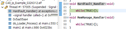

Left view is on Text editor and right is S32DS debugger.
And last memory is below.
And then jump to application
FunctionPointer functionPtr = (FunctionPointer)(*(uint32 *)0x00500000);
(functionPtr )();
HardFault_Handler will occurr.
How do I jump to 0x00400000 or 0x00500000 position after completing Flash write with Bootloader?

thanks for your suggestion i tried with the procedure you indicated me but I still can't run the application, the applications gets stuck in HardFault_Handler (image below).
Do you have any further suggestion? Did you perform any specific modification in the application linker file?

I have the same problem you described, one binary file placed at address 0x0400000 ( i named it bootloader) and a second one at 0x0500000 (application). When I perform the Jump from BootLoader to Application as described in NXP support reply post, the jump appears to be correctly executed but then the execution either stops at cpsid instruction, as showed in attached picture, or goes into HardFault_Handler.
Did you manage to find a working solution?
