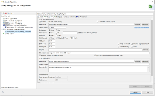

Open:RUN->Debug Configurations

Hi @Senlent

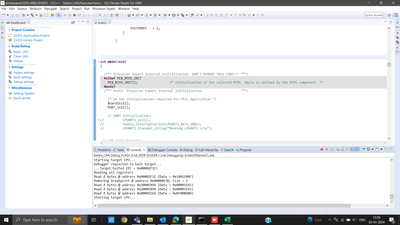

I usually do the same thing for debugging process. But when i want to dump the code to the board i usually open debugging window and press play

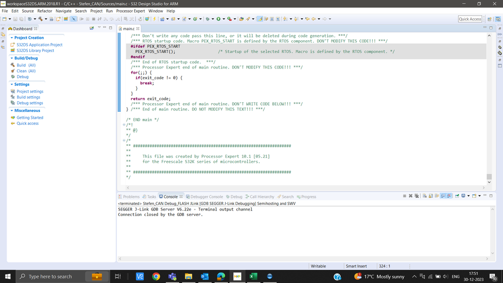

and then remove the chords of J-Link Debugger module from the board and my pc. And once i do this it gives the following pop up.
But even after this pop up the board is flashed with the code and operates normally how it is intended to. But recently i noticed a something different which is when i connect the J-link debugger and process and start the debug and press resume on the debuging window all my CAN related frames are working normally but when i remove the chord as i said earlier i started noticing some missing CAN frames. So, that is the reason i was asking you for the right way to flash the code in to the board. Can you please help me identify what is the reason of the missing CAN frames.
When the debugger is connected and when i press the resume the debugg session the CAN frames are being received with out any trouble but when i discinnect the J-Link Debugger hardware from my PC or fromt the board. I am starting miss some CAN frames. This is the issue. And from my point of i veiw i beleive the issue might be with the abrupt diconnecting  of J-Link Debugger Hardware from my PC.

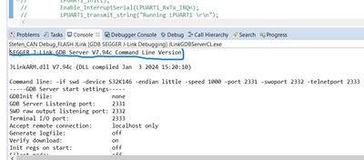

My software version is SEGGER J-Link GDB Server V7.94c Command Line Version
But how can i check whether my J-Link is above V9.4 and above.
I tried to perform the operartion of flashing the target MCU and disconnecting as you mentioned earlier. But my disconnect option is disabled on my software. So, i am trying to figure how can i enable that disconnect option.

1. There will be hardware version information on the debugger, or you can use J-Link Configurator to get the current version information
2.Sorry, the "disconnect" option cannot be used (I reproduced the problem), so you can use the "Terminate" option
